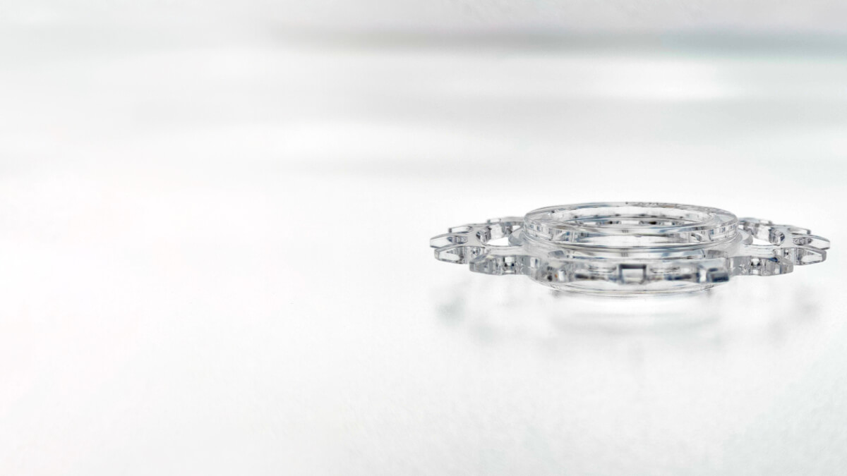

About the Process
Hand polishing is a manual process where the part is sanded, then buffed on a set of abrasive wheels or rouges to achieve the desired surface finish. This is a subtractive process that removes material in order to eliminate scratches and other imperfections.
Design considerations
  • Radiused corners and edges generally produce better results than sharp ones
  • Wall thicknesses less than 1.5mm do not hold up as well during polishing
  • Internal or hard to reach features (including threads) are difficult or impossible to polish
  • Very tight tolerances, reamed holes, and threads may need to be excluded from polishing
