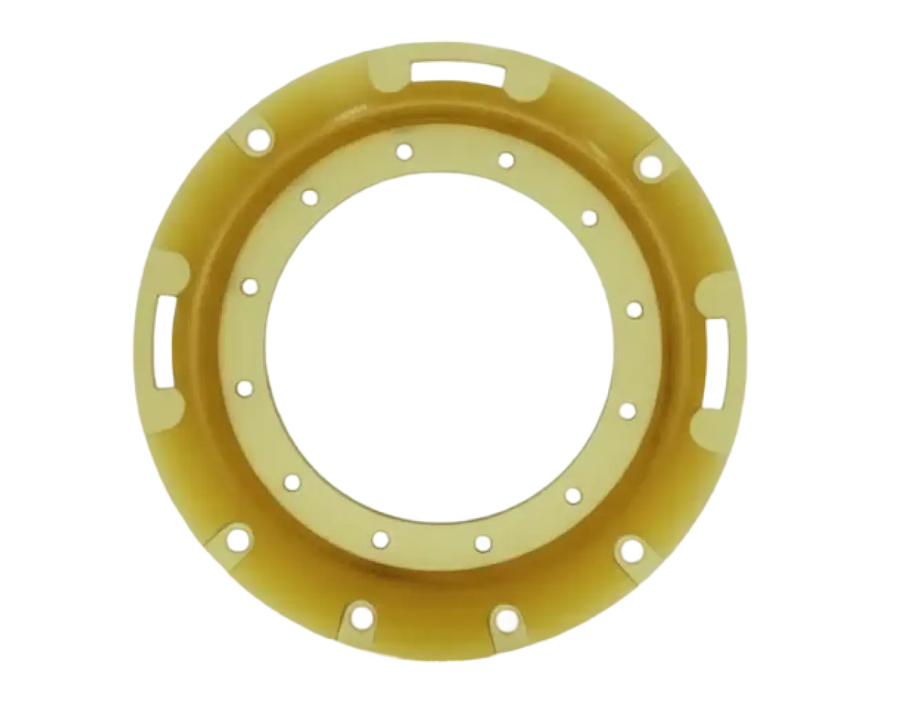

ULTEM 1000 is a translucent amber colored plastic with excellent durability, strength, stiffness and heat resistance. ULTEM 1000 may be selected over Nylon or Delrin because it has the highest dielectric properties. Common applications include industrial equipment, medical devices and electronics.

Ultem comes in a naturally translucent amber color. When machined, it is smooth and becomes slightly frosted. Additionally, ULTEM can be machined to a variety of surface roughnesses.
